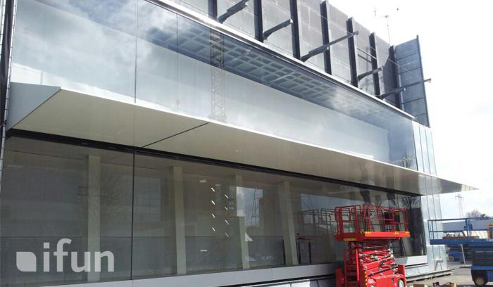

Construction at Apple's "Spaceship" Campus has been progressing at a rapid pace in the past few months, as the company most recently began putting up the outer walls and laying roadwork. Now, iFun.de (Google Translate) shares new photos of the steel and glass material that will be used for the campus' facade, which are being provided by German company Josef Gartner GmbH.
spaceship_facade_materials
Construction material for Apple's Spaceship Campus tested by Josef Gartner

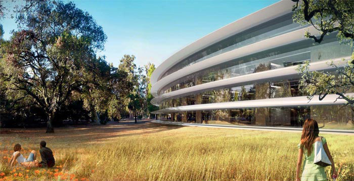

The images show the steel and glass components being tested by Josef Gartner outside of its premises, and could hint at the scale of Apple's new Campus 2 building upon completion. The building will have a circular, multi-story structure surrounded by greenery, additional buildings, performance stages, a fountain, and more.
spaceship_facade_concept
A concept image of what the front of Apple's Spaceship Campus will look like
Apple's Campus 2 project will be constructed in two phases, with the first phase finishing up by 2016 and including a 2.8 million square-foot ring-shaped central building, an underground parking facility, a 100,000 square foot fitness center, and a 120,000 square foot auditorium. Meanwhile, the second phase of construction will take place after 2016 and include an additional 600,000 square feet of office, research and development buildings as well as an additional parking structure with 1,740 spaces.

In construction, this is what is referred to as a "mockup" wall. I believe MacRumors is familiar with that term...
Required of the contractor in the building specifications, its purpose is to demonstrate to the architect that the fit and finish of all components meets the design criteria, which in the case of this building are insane (1/32" tolerances, etc.). Good luck, guys.
In this case, because it's Apple (and Sir Norman), the priority might be fit-and-finish, but more importantly, mockups are commonly used for envelope testing and for observing detailing with respect to air/water infiltration, i.e. non-glamorous things like flashing and air barriers. Here they may also be looking at light control via the shading devices as well.
1/32" of an inch isn't really a big deal in construction these days. Tight tolerances are especially desirable with external walls to prevent them from looking wavy and shoddy.
You either aren't really "in construction" or must only work on museums. If it's the latter, I'm jealous.
I've designed buildings that cost $1,100 a square foot, and even then we only got down to 1/16". In typical commercial construction "these days," 1/8" is the norm for dimensioning, but 1/2" for joint and structural steel tolerances are more common. Furthermore, governing bodies and industry agencies allow much more than 1/32" tolerance (out of plumb, variation in dimension over 10' etc), precisely because it doesn't look wavy and shoddy up to that point.
Score: 2 Votes (Like | Disagree)
