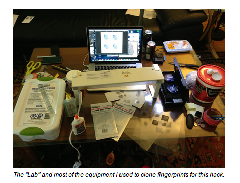

While Starbug suggests that the hack is "very easy" and can be completed with "inexpensive office equipment like an image scanner, a laser printer, and a kit for etching PCBs," Marc Rogers, who also completed the bypass, disagrees, noting that it requires "over a thousand dollars worth of equipment."touchid
But, the reality is these flaws are not something that the average consumer should worry about. Why? Because exploiting them was anything but trivial.
Hacking TouchID relies upon a combination of skills, existing academic research and the patience of a Crime Scene Technician.
Rogers goes on to explain the process, which requires an unsmudged, complete print of the correct finger and a way to “lift” the print using cyanoacrylate (super glue) fumes, fingerprint powder, and fingerprint tape. The lifted fingerprint must then be photographed, edited, and printed onto transparency film, where it is converted to a usable fingerprint via a PCB board or a laser printer.
Even when all of these steps are created, using the fake fingerprint was "tricky" and prone to failure.
