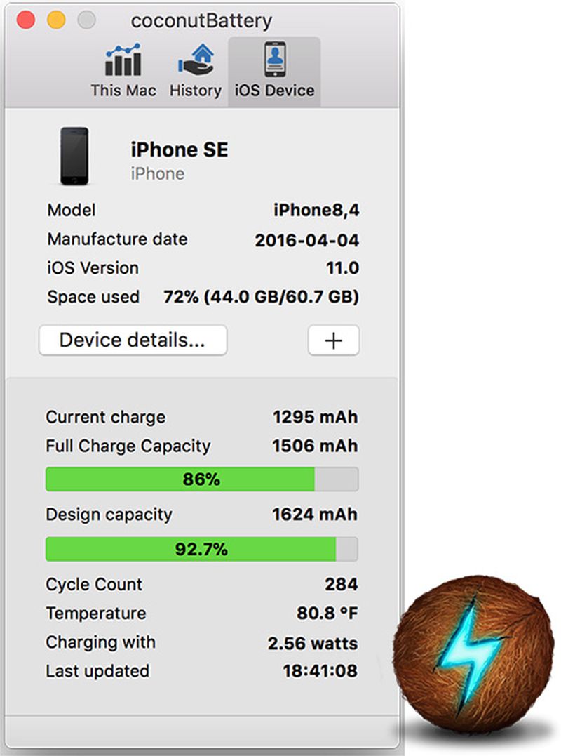

- Benchmark your iPhone: Download the Geekbench 4 app from the App Store and benchmark your iPhone. Each CPU workload models a real-world task or application. If your iPhone has noticeably lower scores compared to the averages, it could be due to Apple's power management feature artificially kicking in.
- Use coconutBattery: Download, install, and open coconutBattery for Mac, connect your iPhone to your Mac with a Lightning to USB cable, and click on the iOS Device tab in the app. Here, you can view your iPhone's battery capacity, which if low suggests your device may be slowed down only when necessary.
coconutbattery iphone
