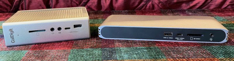

The USB-C Pro Dock has a horizontal design more typical of Thunderbolt 3 docks, as opposed to the TS3 Plus. I prefer the design of the TS3 Plus, but the USB-C Pro Dock design is certainly suitable and allows the dock to sit unobtrusively on a desk. It comes in a Space Gray aluminum that closely matches Apple's notebooks of that color, with some finning on the sides to potentially assist with heat dissipation and black plastic on the front and back.
The dock weighs just under a pound and measures in at about 8.5 inches wide, an inch high, and a little over three inches deep. It's powered by a fairly large external power brick as is typical of these docks, although the brick included with this dock is a bit flatter than some others I've seen and most users should be able to tuck it away on or behind a desk.

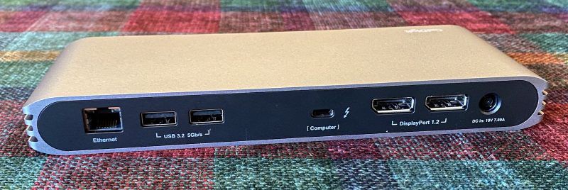

When it comes to display compatibility, the USB-C Pro Dock includes a pair of DisplayPort 1.2 connectors, and active adapters can be used to convert to other standards like HDMI. When connected to a Thunderbolt 3-equipped Mac like a MacBook Pro or recent MacBook Air, the USB-C Pro Dock is able to drive dual 4K monitors at up to 60Hz, offering great expansion capabilities for turning your notebook into a workhorse desktop machine.
Things are little more limited when you're connecting the dock to a MacBook over USB-C, as the slower connection maxes out at supporting a single 4K display at 30Hz or dual HD displays, although those dual displays are unfortunately limited to mirrored mode rather than allowing for a full extended desktop.
The lack of a downstream Thunderbolt 3 port means I likely won't be using this as my everyday dock, as I currently use a pair of LG UltraFine 5K displays, one connected through my TS3 Plus dock and one directly to my computer. I certainly could route both 5K displays directly to the MacBook Pro and use the dock separately for its other functions, but that increases the number of cables connected to my computer from two to three and so it's overall less convenient, particularly when I've already got a TS3 Plus serving my needs.
But for someone maxing out with one or two 4K displays, particularly DisplayPort ones where you won't need any adapters, the USB-C Pro Dock should work out just fine. In fact, CalDigit intentionally opted to sacrifice the downstream Thunderbolt 3 port in order to include two DisplayPort 1.2 ports, since most people end up using the Thunderbolt port to add another display anyway.

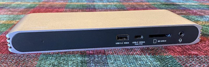

One of the other primary purposes of a computer dock is to provide additional USB ports for connecting a variety of accessories to your computer all through a single cable. The USB-C Pro Dock includes three 5 Gbps USB-A ports (one on the front and two on the back), as well as one data-only 10 Gbps USB-C port on the front of the dock.

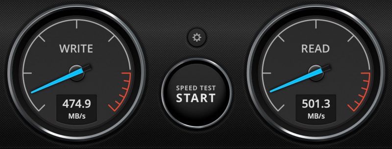

Connecting a fast CalDigit Tuff external SSD to that 10 Gbps front USB-C port and to my MacBook Pro, I found solid speeds of 475 MB/s write and 500 MB/s read, which is typical for this drive over a 10 Gbps connection. Using the same setup but connected to a 2015 MacBook over USB-C, I saw speeds dip slightly to 411 MB/s write and 415 MB/s read, but that's still solid performance.
The front-facing USB-A port on the USB-C Pro Dock supports standalone charging, so you can charge your iPhone, Apple Watch, or other devices via the dock even when your notebook isn't connected or turned on. CalDigit also provides a driver to increase the power available over USB to allow the dock to support Apple's SuperDrive.

Moving beyond displays and USB, the USB-C Pro Dock includes three additional features to increase the capabilities of a connected computer. One is a Gigabit Ethernet port to give you a speedy and reliable wired data connection, and the other is a UHS-II SD 4.0 card reader to make it easy to quickly transfer photos and files from a standalone camera or other devices.
Finally, there is a 3.5mm combination analog audio in/out port on the front of the dock to support speakers, headphones or combined headphone/microphone headsets.

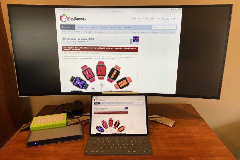

While Thunderbolt and USB docks have traditionally been used to expand the capabilities of Macs, the adoption of USB-C on the iPad Pro has opened the door for Apple's tablets to take advantage of USB-C docks as well, and CalDigit's USB-C Pro Dock does the job here as well.
With a single cable connecting your iPad Pro to the dock, you can open support for an external display running at up to 4K and 60Hz, USB-connected drives, SD cards, ethernet, and audio in/out. The dock also lets you use external accessories like keyboards and mice, and it allows for fast charging of your iPad Pro.
