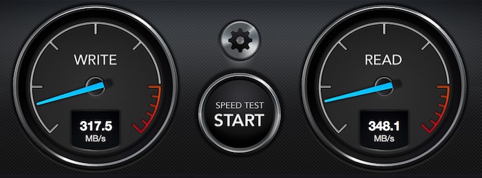

In my testing with a 10 Gbps USB 3.1 Gen 2 CalDigit Tuff external SSD and Blackmagic's speed testing software, I saw read and write speeds come in around 350 MB/s and 315 MB/s respectively through all of the 5 Mbps USB ports, both Type-A and the front Type-C style. Those are very typical speeds for these types of docks.

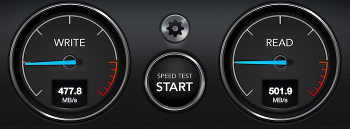

Where the TS3 Plus has a leg up on the competition in the speed department is the extra Type-C 10 Gbps USB 3.1 Gen 2 port on the rear of the dock. Connecting the CalDigit Tuff to that port yielded a 45–50 percent increase in transfer speeds, coming in at around 500 MB/s read and 475 MB/s write.
Other docks can match that performance if you use the downstream Thunderbolt 3 port, but then you have to sacrifice connecting a Thunderbolt 3 or USB-C display to that port. With the TS3 Plus, you can have both, and transfer speeds over the 10 Gbps USB-C port aren't impacted by also having a 5K display connected to the Thunderbolt 3 port, as there is enough bandwidth over Thunderbolt 3 to support both without compromise.
