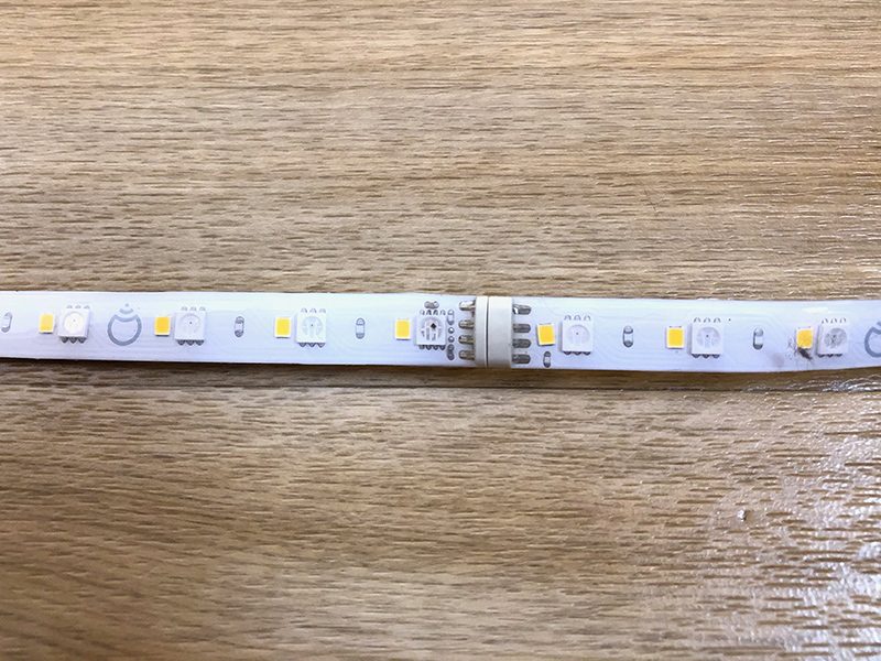

The LIFX Z light strip is thinner than the Philips version, and it comes in two pieces that attach together with thin metal prongs. The Hue LightStrip is all one piece and is thicker, so it feels sturdier. I'm worried about the longevity of the LIFX Z, especially if I choose to move it sometime in the future because of the delicate prongs and the thinner design.
lifxconnector
LIFX Z has two LEDs that are close together, a design that repeats, while Hue uses three repeating LEDs. In actual usage, both seem to output the same general shades with the same level of accuracy. Purple, for example, is a struggle for both, but most other colors work well. I didn't see a huge difference between the two, color for color.

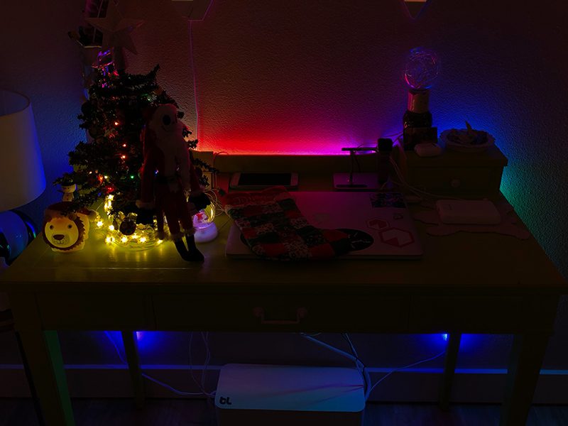

I attached the LIFX Z to my desk, across the back of it and down each leg. The adhesive works fairly well, but there is one section that keeps coming unstuck, so I'll need to secure it with new adhesive. There's no easy way to get the light strip to go around corners, so that's a bit of an awkward setup, but since my desk is against the wall, it's not visible.
lifxadhesive

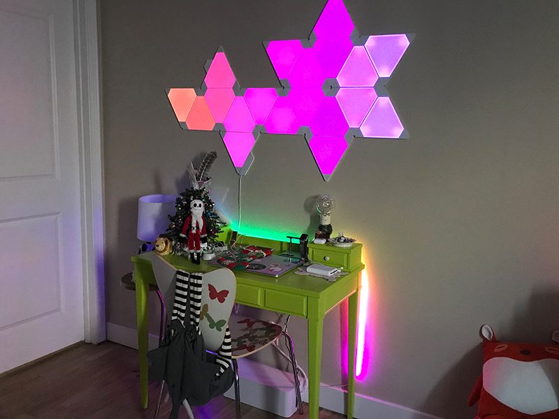

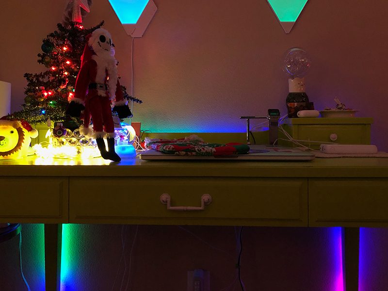

It's difficult to capture the look of the LIFX Z on camera, but it adds a very neat backlighting effect to my desk that complements the Nanoleaf Aurora I have on the wall above it. People use these light strips under counters, behind TVs, on shelving, and anywhere else six feet of lights can manage to fit. At maximum brightness, the LIFX Z can be a little distracting, but at about 50%, it's a great accent light.
lifxbehinddesk

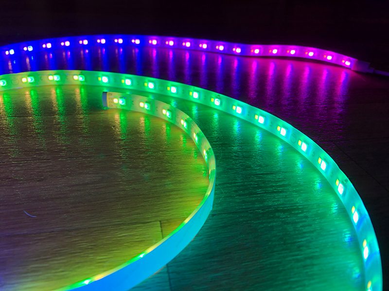

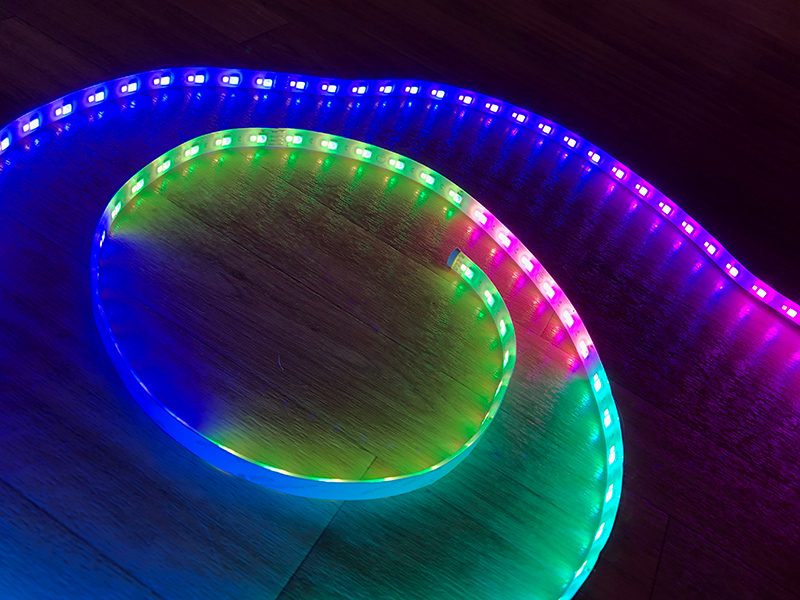

LIFX Z's major draw over the Philips Hue LightStrip Plus is its support for color zones. There are 8 zones per strip, for a total of 16 zones that can each be set to a different color. The LightStrip Plus, meanwhile, can only be set to a single color at a time.

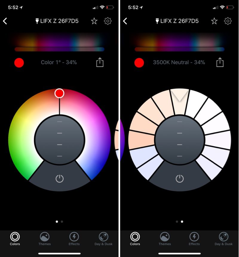

The main point of control for the LIFX Z is the LIFX app, which I have mixed feelings about. It has a somewhat confusing interface with three separate areas for changing the color of the lights, and every time I open it, it seems to turn off my music even with its access to the microphone disabled.
lifxcolorzone2
There's a main "colors" section in the app for setting the light strip to a single color, with the color wheel separated into colors and whites. There are a lot of white presets, which is nice, and the color wheel setup is easy enough to use. If you swipe in the middle, it brightens or dims the LIFX Z, which isn't super intuitive.

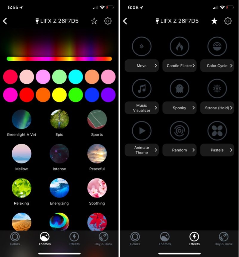

A separate "Themes" section is where you can take advantage of the different zones. There are several multi-colored presets, and you can also use the 14 colors in a color palette at the top of the section to "paint" colors onto the light strip. This is neat, but the interface could be improved to allow for more precise color choices, and it would be nice if all the colors were available. If you accidentally tap a color instead of dragging it into the painting interface, it also ruins all your work, which is a point of frustration.
With the Themes section, for some reason, whenever I tap on one of the pre-sets, one section of the LIFX Z refuses to respond, which is bizarre. I can paint on it using the included tools, and it responds to full color changes, but not the pre-set Themes. LIFX tells me that this is a known bug and that a firmware update is coming soon to fix the problem.

Along with themes for painting specific colors onto the LIFX Z, there's an "Effects" feature and an option for automating it to come on at dawn and dusk. Effects, like multiple color zones, are not supported by Hue. Hue does, however, support automation for turning the lights on and off at specific times.
lifxzone2
With Effects, you can set animations like "Candle Flicker," "Color Cycle," or "Animate Theme" to cause the colors to shift in accordance with the effect selected. The LIFX app needs to run in the background for these effects to work. There's also a Music Visualizer option that listens to ambient sound to animate the lights, similar to the Nanoleaf Aurora Rhythm.
