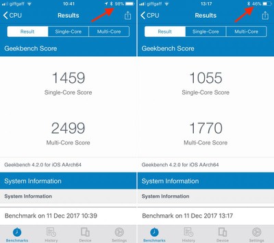

According to TeckFire, the author of the original Reddit post, their iPhone had been very slow after updating to iOS 11, especially compared to their brother's iPhone 6 Plus, so they decided to do some research with GeekBench and battery life apps, and ended up replacing the battery.
iphone 6s geekbench battery
MacRumors' Geekbench scores for iPhone 6s before and after battery drain
Wear level was somewhere around 20% on my old battery. I did a Geekbench score, and found I was getting 1466 Single and 2512 Multi. This did not change wether I had low power mode on or off. After changing my battery, I did another test to check if it was just a placebo. Nope. 2526 Single and 4456 Multi. From what I can tell, Apple slows down phones when their battery gets too low, so you can still have a full days charge.

This weekend's Reddit thread – running to over 500 comments as of writing – appears to have kicked off a wave of speculation about whether the two shutdown issues are in fact related, and that Apple's fix involves dynamically throttling the phones' maximum clock speeds relative to battery output (voltage), to prevent them from drawing too much power and shutting down.

In the meantime, users interested in checking their phone's performance are also using the free CpuDasherX app to compare running clock speeds (a factory iPhone 6s comes in at 1,848MHz, for example). Let us know your findings in the comments below. Lastly, it's worth noting that DIY iPhone battery replacements or repairs performed by a third party will void any Apple warranty still covering said devices.

Not sure I'm following this guy's logic. He owns a model of phone that has a known battery issue for a small number of units, experiences some issues, then replaces that battery and gets better performance. But his conclusion isn't that the battery was defective and fluctuating as a result of the known defect, but rather that Apple is throttling through software?

CPU throttling is a basic function of any decent BMS. They have a throttle pin which is directly connected to CPU to reduce system load or else the BMS will have to cut all power to keep the battery voltage from dropping below critical.
If battery does drop below critical voltage, it could internally short-circuit and/or swell and cause fire.

I already posted my findings with screen shots in the other thread, but here’s my experience:
I have two iPhone 6's one on ios 11 and one on iOS 9. Both are 2 1/2+ years old.
I’ve been having speed issues with the iOS11 iPhone. Once I read this article, I checked my Geekbench scores and found I got 1050 versus the 1400 or 1500 I should’ve been getting.
The iOS9 phone clocked in just fine.
I replaced the iOS11 battery and am cruising alone much better.
What’s behind this all, I have no idea, but the symptoms and cure seem to bearing out as positioned in the article.
Oddly, my new-battery iPhone 6 performs better now in low power mode than it did in regular mode with the old battery. Something is not correctly optimized with these older phones.
