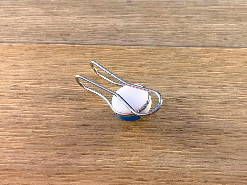

The My Skin Track UV Sensor ships in two pieces. There's the blue and white plastic sensor portion, and a metal clip designed to fit on a sleeve, shirt collar, or cap where it can be exposed to the sun.
The sensor slides into the metal clip, which can be a little bit tricky. I'm not sure why it's shipped in two pieces because there isn't ever a need to take it out of the clip, but maybe La-Roche Posay is planning to release different enclosures in the future.
Size wise, the Skin Track Sensor is tiny. It's about the same size as my thumb nail, and I have a small thumb. There's a little window on the sensor that houses the UV detecting equipment and an NFC chip, with the window designed to let in light for tracking purposes.
As mentioned above, the clip is meant to be attached to an item of clothing that's regularly in the sun, but the clip is imperfect. You can put it on a shirt sleeve, collar, hat, or elsewhere, but there's no closure at the back so it's very easy for it to slip off.
For a while, I was wearing it on my Apple Watch band, but it kept sliding off. I tried it on my sleeve, but that was worse, and so was the collar of my shirt. There were times when I lost the sensor for a few hours in the house, and if I hadn't been super vigilant about keeping an eye on it when outdoors, I definitely would have lost it.
It's really prone to falling off, and I can't stress that enough. I'm not sure anyone is going to be able to keep this thing for any length of time because of that clip design, so if you get one of these, try to find some way to secure the end so it's not going to be gone forever if it slips off.
My ultimate solution was putting it on the thick handle of my backpack where it was such a tight fit that it couldn't slide off. When I'm out, I usually have my backpack with me, so this was an okay solution for me. That wouldn't work for running, visiting the beach, workouts, or any other similar activity, though.
I don't think there's anywhere else I could reasonably put it without losing it, and I think it's amazing that I've managed to keep it without losing it so far.
