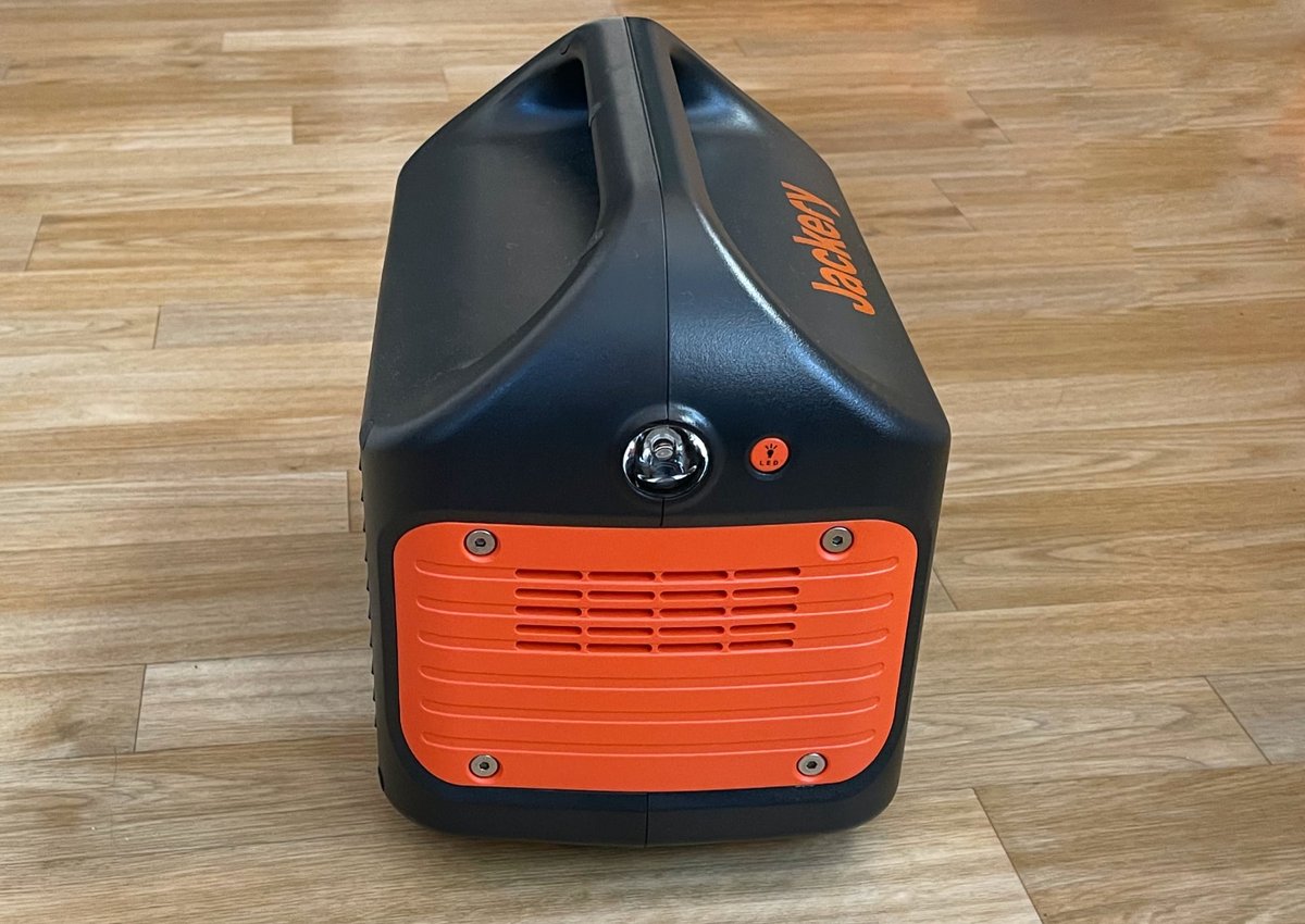

The Jackery Explorer 500 Portable Power Station is not your average battery pack - at just over 13 pounds, it's hefty and not something you're going to want to walk around with.
The E500 has a super rugged design that's going to hold up to abuse, which makes it perfect for camping and use outdoors. Both the shape and the ergonomic handle make it easy to carry, and though large, it has an attractive design.
jackery e500 design
It's made from a black plastic material with orange accents and fan vents on the side. There's a small LCD display on the front, which is one of the handiest features. You can press on the display button to see the current charge level, the power draw of any connected devices, and the input power.

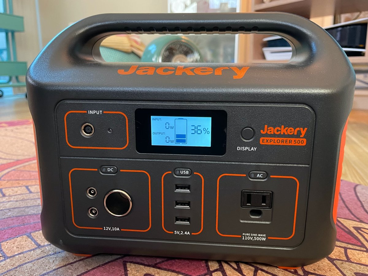

Next to the display there's a small input port for charging, and below that, there are a series of ports. At the sides, there's another button that toggles on a built-in LED light as a flashlight feature, which is a nice addition.
Ports

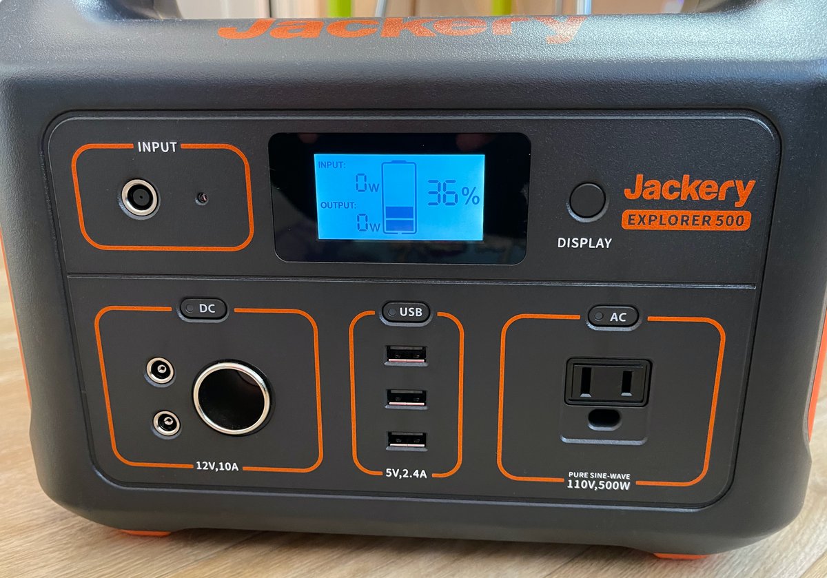

There's a standard 110V AC port that support up to 500W and 1000W surge, two 12V/7A 6.5x1.4mm DC outputs, a 12V/10A car outlet, three 2.4A/5V USB-A ports, and a DC input for charging purposes.
The number of devices and cables that use USB-A is dwindling, and at this point, more of my electronics have USB-C cables than USB-A cables. I wish the Explorer 500 had USB-C ports available both for convenience and for charging devices like my MacBook without having to pull out a power adapter, but unfortunately there are no USB-C ports.
jackery e500 ports
Aside from that, there are a good mix of ports available. The three USB-A ports can be used for your smaller devices that need minimal power, while the AC outlet works for just about anything.
As for the two 6.5x1.4mm DC output ports, I'm not sure most people are going to have devices able to take advantage of these. I do not. There is a 6mm DC to car cigarette lighter port converter that works with them, allowing for two car-compatible ports, but you will need to purchase this kind of adapter separately.
There are on/off switches for the DC, AC, and USB outputs, so these need to be turned on whenever you're charging something. Disabling them prevents power draw and keeps the battery in stasis so it's not draining. I haven't had the E500 long enough to test its ability to hold its battery over long periods of time, but it was able to maintain a charge for a week even when not in use.

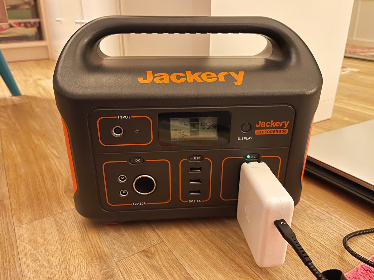

With my 15-inch MacBook Pro, I tested charging twice. The first time it took 20 percent of the battery to charge from zero to full, and the second time, it took 19 percent. So if you weren't using it for anything else, the E500 could charge a ‌MacBook Pro‌ to full about five times.
jackery e500 charging macbook
Charging my ‌MacBook Pro‌ to full took about two hours, which seems about full speed. I'm not 100 percent sure the LCD is giving me accurate watt levels when charging because it seemed to max out at about 75W and fluctuating at around 60 to 70W, while the ‌MacBook Pro‌ is capable of charging at 85W, but the charging didn't seem slow.

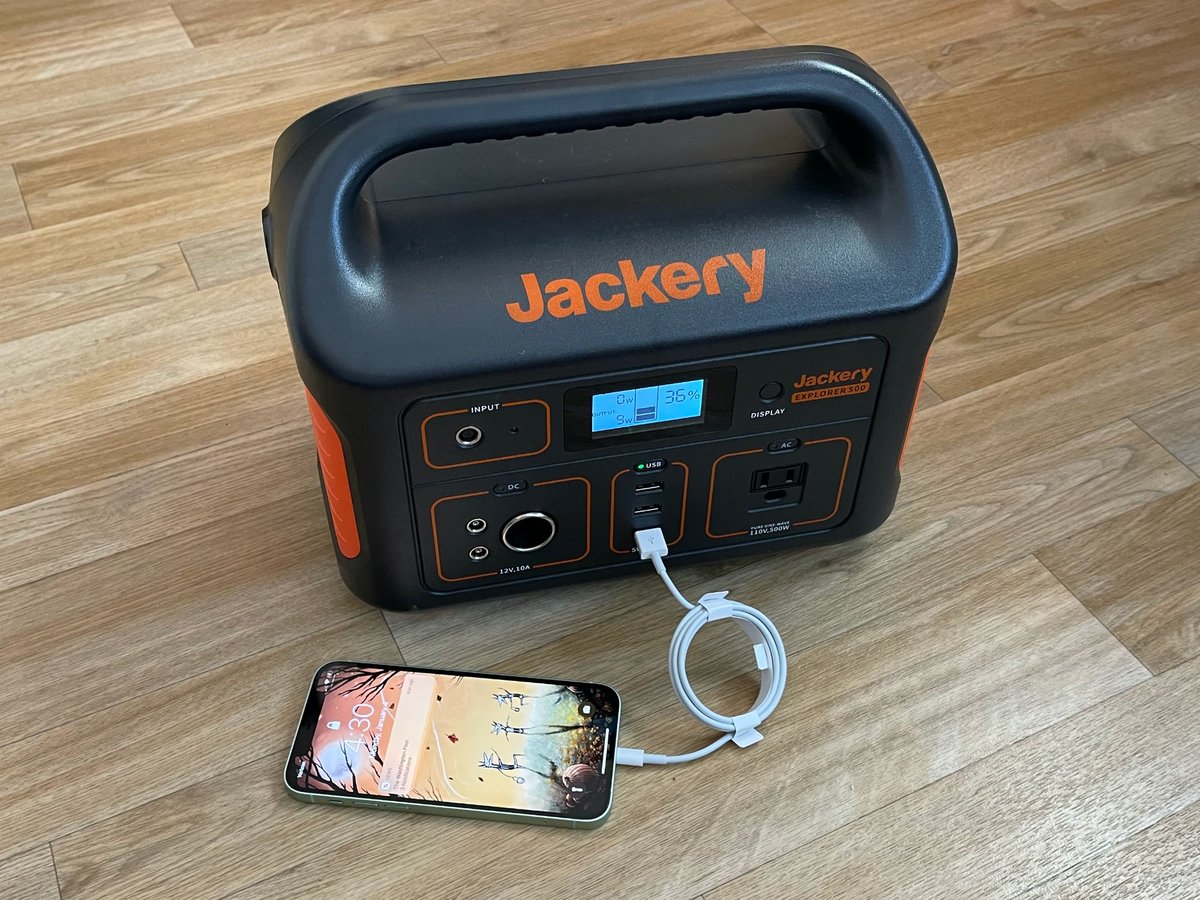

With my iPhone 11 Pro Max (the iPhone with the largest battery I have), it took three percent of the E500's battery to charge it up the first time I tested and four percent the second time, with the charge taking it from dead to full. Based on those metrics, I estimate that I could charge an ‌iPhone 11 Pro Max‌ about 29 times with the E500.

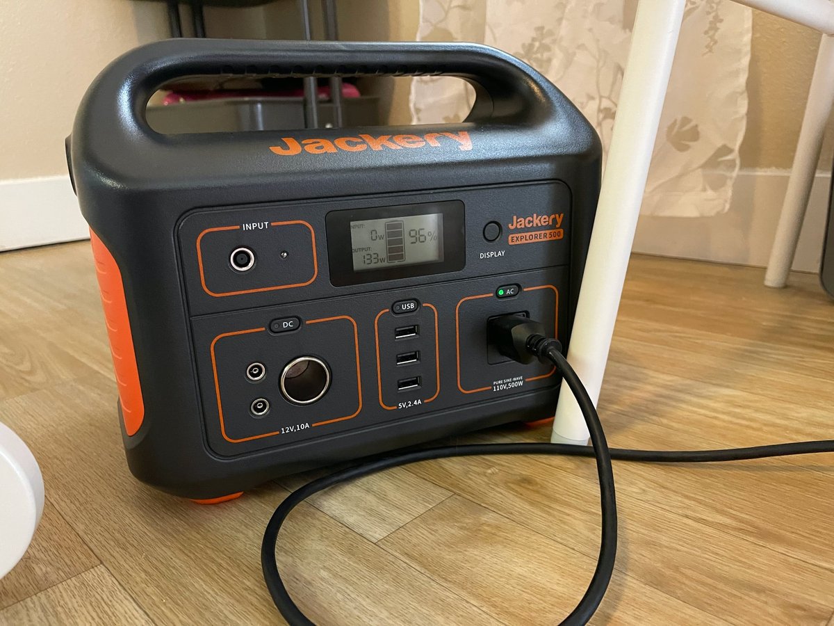

I tested the E500 with a Razer gaming laptop in use drawing around 150W on average, and it was able to last for a full four hours. I plugged in the laptop at 1:30 p.m. and the Jackery died at 5:40 p.m.
With my Dyson Air Purifier, I plugged it into the E500 at 12:00 p.m. and set it to medium, and it ran for 24 hours straight. When I finished this test, the E500 was still at 43 percent battery life, so for devices like fans and lights that have less power draw, it can work for quite some time.
I know the E500 is compatible with a wide range of little appliances like mini fridges, but I found out that a lot of my standard appliances draw too much power. My small Vornado heater, for example, is 750W/1000W depending on the power level, and my Vitamix blender is up to 1500W, so these aren't compatible.

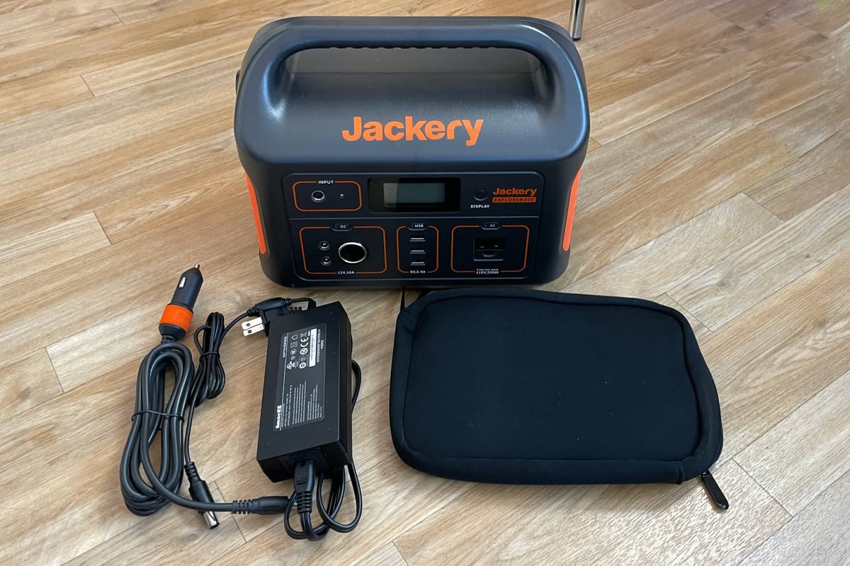

The E500 itself can be charged with a wall socket with the included power adapter that plugs into the input port, in a vehicle using the 12V port, or with a Solar Panel that Jackery sells as an add-on accessory. There's no charging method for this battery that's especially fast, which is one of the downsides to this charger. It takes about 7.5 hours to charge up to full using an AC adapter, and more than twice as long with the car adapter. Solar charging can be done in as little as 9.5 hours, but that depends on the conditions outside.
jackery e500 cables
Note that passthrough charging is possible, so you can charge up devices that are plugged in while the E500 is plugged in to charge.

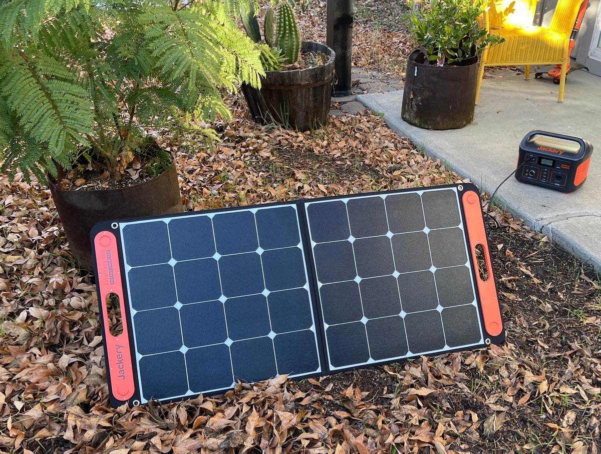

Solar Charger

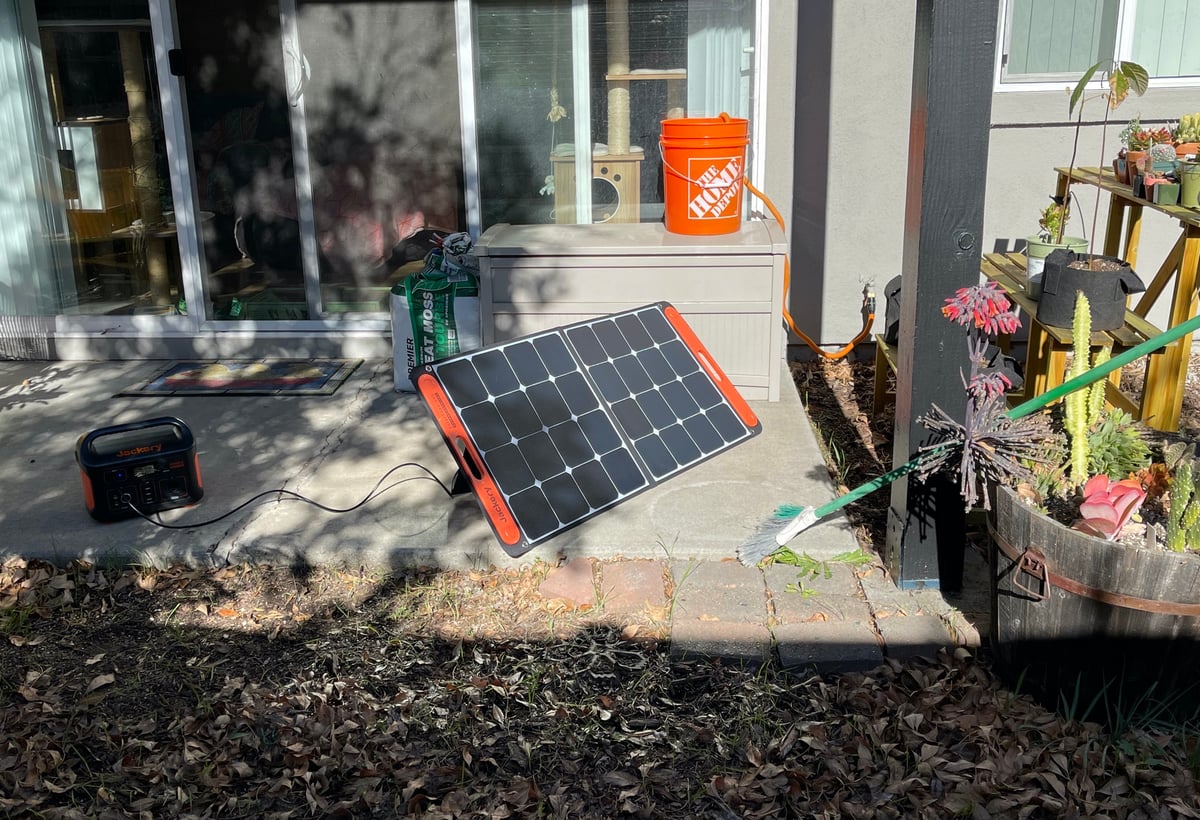

Jackery sells a 100W Solar Panel alongside the Explorer 500, which uses the sun to charge it up so it can be used continually off grid. The SolarSaga Solar Panel is huge, which seems appropriate since this is a large battery.
jackery solar panel 1

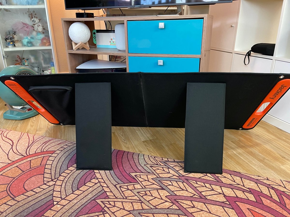

Even though it's a little unwieldy, I appreciated the design of the SolarSaga. There's a handle that makes it easier to transport, and it folds in half. There's also a pouch on the back for storing the charging cable, which was convenient.
jackery solar panel 4
The SolarSaga connects to the E500 through a built-in DC cable that plugs into the Explorer, and it's simple to use. I just plugged it in and set up the panel using the included velcro-attached kickstands that let it be angled towards the sun. It took me all of two minutes to get it ready to charge.
Given that it's winter right now, we're not getting a whole lot of sun in Northern California, but I picked the day with the sunniest forecast for testing. I plugged in the SolarSaga in the morning, but I didn't see it charge over 20 percent over the course of the day nor did I max out its charging capabilities because it just wasn't sunny enough. In the most sun I could find during the winter, the SolarSaga was providing just about 60W, which would be enough to keep smaller appliances up and running.
jackery solar panel 2
If you want to get the full charging power out of the SolarSaga, you're going to need good, direct sunlight that's not obscured by trees or other objects, so keep that in mind.
You're going to have quicker charging times when there's full sun to take advantage of, so the usefulness of the solar charger depends on where you're taking it. For a sunny camping spot, it might be able to keep many of your smaller devices topped off over a week, and if you're getting a full sun all day, you'll have enough power for large devices, too.
jackery solar panel 3
Jackery says that it should take around 9.5 hours to charge the battery to full, but I assume that's in optimal sun conditions. You can also plug devices directly into the SolarSaga because it has a USB-C port and a USB-A port.
