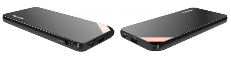

Earlier this week, mobile accessory manufacturer ibattz turned a few heads at the Consumer Electronics Show with a new external battery charger called the ASAP Fast Charge Power Bank that the company claims can fully charge an iPhone 6 from 0 to 100 percent in just 15 minutes. (See update at bottom of this article for correction.)
Available in two sizes of 5,600 mAh and 11,200 mAh, the new charging banks are the company's fastest to date. By using lithium polymer batteries and replacing the traditional 5V 1A input with a 20V 2A upgrade, the company says the ASAP charging banks can reach a recharge speed of up to four times faster than traditional external battery packs.
Screenshot (98)
No specifications have been given on the charge time for any device besides the iPhone 6, and no pricing or tentative launch date has been announced by the company.
Though the company has a decent track record with its existing lineup of other power bank and battery case devices, hands-on time with the device will be needed to test the company's latest claims. Users will also want to weigh potential long-term negative effects from charging their phone batteries so quickly in deciding whether ibattz's new power banks will be a worthwhile investment.
Update: ibattz has clarified to MacRumors that the power bank itself can charge in 15 minutes, with charging of an iPhone from the bank taking about an hour. The company has not yet updated its press release to correct the error.
