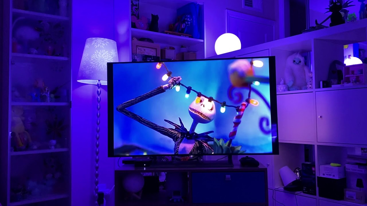

I had mine set with a Hue Lightstrip, a Hue Go, and a few standard Hue bulbs that are located close to the TV in my office, which worked well, though I imagine it would be even better with a Lightstrip and a few of the Hue Play Light Bars.
huesynctvshow2
