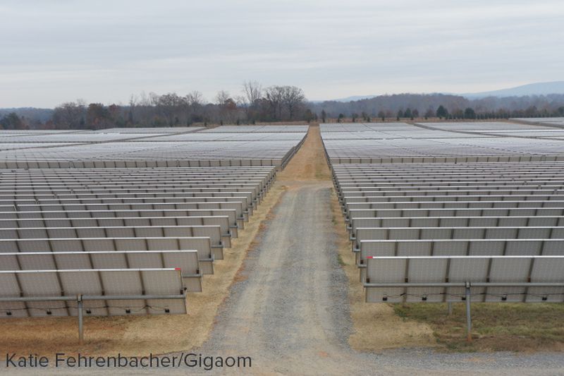

Apple’s solar panel farms were built and are operated by Bay Area company SunPower. SunPower manufacturers high-efficient solar panels, solar panel trackers and also develops solar panel projects like Apple’s. The solar farm across from the data center has over 50,000 panels on 100 acres, and it took about a year to build the entire thing.
Each solar panel on Apple’s farms has a microcontroller on its back, and the panels are attached to long, large trackers (the steel poles in the picture). During the day, the computers automatically and gradually tilt the solar panels so that the face of the panels follow the sun throughout the day. The above picture was taken in the late morning, so by the end of the day, the panels will have completely rotated to face where I was standing. The trackers used are single-axis trackers, which basically means they are less complex and less expensive than more precise dual-axis trackers.
Apple works with a company that provides sheep to eat the grass underneath the solar panels, an environmentally friendly alternative to mowing.

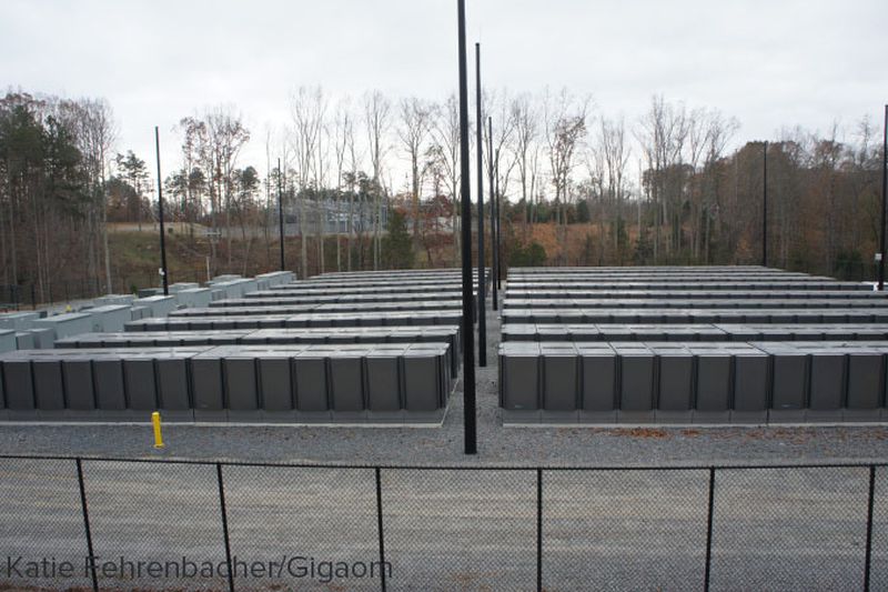

For its fuel cell facility, Apple uses biogas fuel cells made by Bloom Energy. Biogas is an alternative to natural gas that can be captured from decomposing organic matter like landfills, water treatment facilities and farms. Natural gas is significantly cheaper, but is a nonrenewable fossil fuel.
Biogas Fuel Cells
When I was walking around the outside of the fuel cell facility I could also see a couple of people doing maintenance work on some of the fuel cells. I’m not sure what they were doing exactly, but fuel cells need some level of maintenance to keep them provided with the fuel, as well as to replace moving parts like fans. Every few years they also need to have a key part replaced called the stack, which can lead to expensive maintenance costs for the fuel cell operator.
