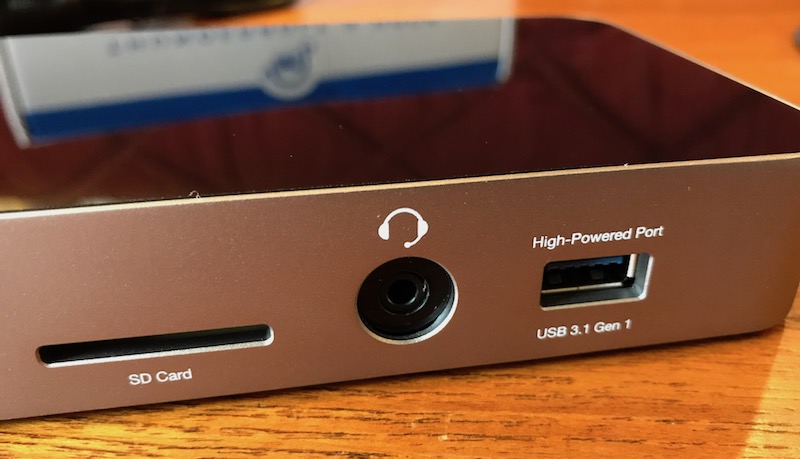

As for the functional aspects of the dock, OWC has elected to put three frequently used ports on the front: an SD card reader, a combo audio in/out port for headphones and microphones, and a USB-A 3.1 Gen 1 port that delivers up to 1.5 amps of current. It's a handy set of ports that are most likely to need regular access for connecting and disconnecting peripherals or swapping out memory cards.
owc tb3 dock front

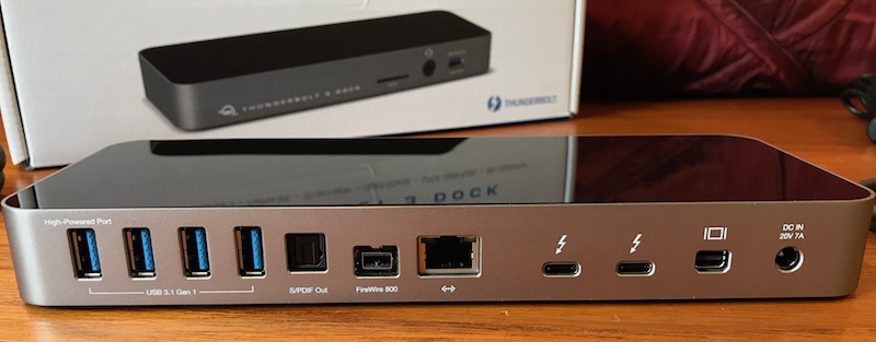

The rear of the dock includes ten more ports plus the DC power input from the external brick. There are four more USB-A 3.1 Gen 1 ports, one of which is another 1.5A high-power port while the other three offer the standard 0.9A of current. Also included are an S/PDIF digital audio output port, a FireWire 800 port, and a Gigabit Ethernet port.
owc tb3 dock rear
Next is a pair of Thunderbolt 3 ports, one of which is used to connect to your MacBook Pro while the other can be used to connect a Thunderbolt 3/USB-C display and/or additional Thunderbolt devices. Adapters can also be used to connect devices with other connectors. Finally, there's a Mini DisplayPort to support additional displays.

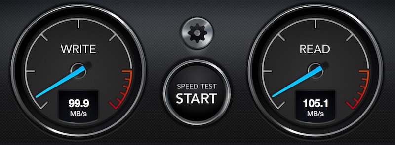

I connected a USB 3.0 external hard drive to the dock and saw read and write speeds right around 100 MB/s, which isn't the fastest connection but will likely be fine for many users. If you need faster speeds, you'll want to use a drive with the latest USB 3.1 Gen 2 standard and connect it directly to your MacBook Pro.
owc tb3 dock usb transfer
