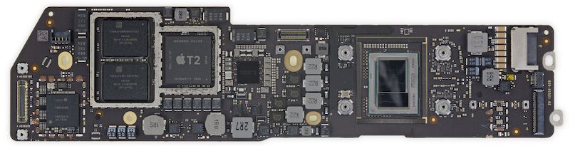

iFixit proceeded to remove the logic board, providing a glimpse at the Apple T2 security chip, along with a Thunderbolt 3 controller from Intel, 128GB of flash storage from SanDisk, and 8GB of LPDDR3 RAM from SK Hynix.

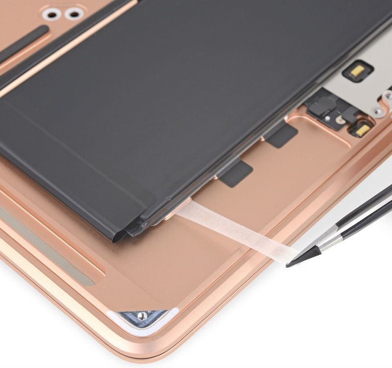

Continuing the repair-friendly trend, iFixit uncovered ten pull-to-remove adhesive tabs securing the 49.9 Wh battery and speakers.
"The mere presence of stretch-release adhesive generally means that someone at least thought about possible repair and disassembly situations," the teardown says. "Are you there, Apple? It's us, iFixit. Have you heard our pleas?"
2018 macbook air ifixit 4
