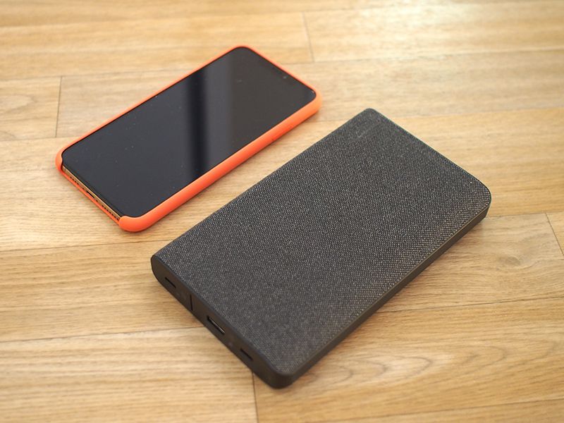

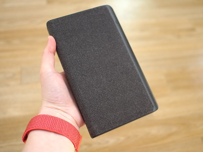

As you might expect with a 26,000mAh device, the Powerstation 3XL is not a small, pocket-sized charger. It's 6.6 inches long and 3.7 inches wide, plus nearly an inch thick.
You can fit this into a bag or backpack without much trouble, but it is bigger than even Apple's largest iPhone, the XS Max. The Powerstation 3XL weighs more than a pound (18 ounces), and it feels like a heavy, sturdy accessory.

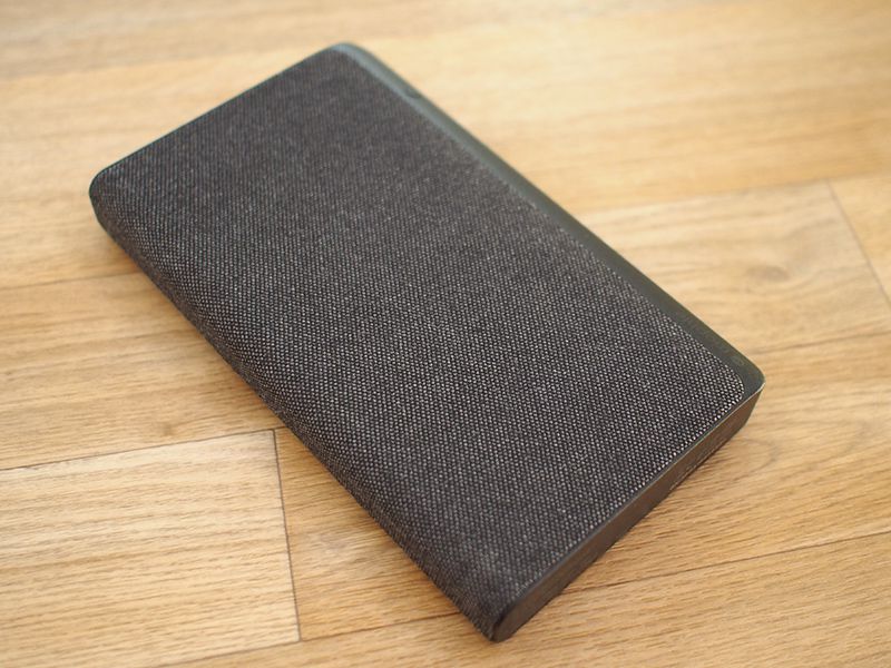

The charger is made from a black plastic material that's covered in a soft, tweed material that makes it easy to grip and adds some flair. Design wise, this is a high-quality charger that looks like it's expensive, which it should, because Mophie is charging $200.

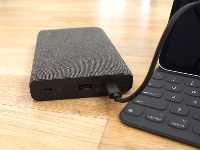

At the bottom of the Powerstation 3XL, there are two USB-C ports, one for plugging into USB-C accessories like the MacBook Air or MacBook, and one for charging the power bank with a USB-C cable. You can tell the two ports apart by a little line and a lightning bolt that indicates which side is used for which.
There's also a USB-A port next to the USB-C charging port so you can also charge USB-A accessories. In total, you can charge one device using the USB-C port and one device using the USB-A port at once, and if you plug in a USB-C cable and a power adapter, you can charge the Powerstation and your devices with passthrough charging.

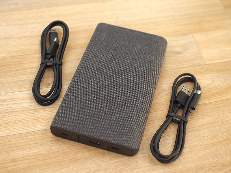

Mophie includes a USB-C to USB-C cable for connecting to your MacBook or other USB-C device, and a USB-C to USB-A cable, which is for charging the Powerstation 3XL.

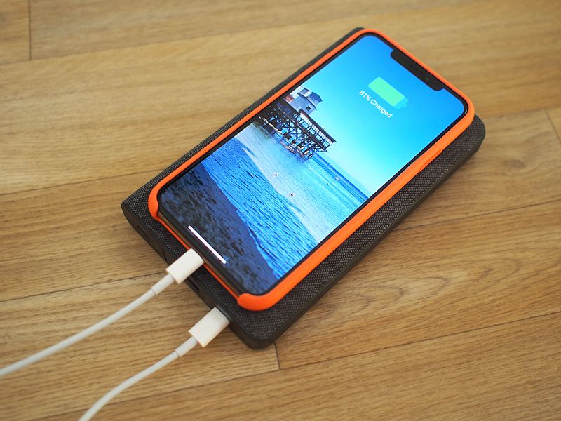

Though not provided, if you combine the Mophie Powerstation 3XL with a USB-C to Lightning cable from Apple (and Apple is the only manufacturer of these cables at the current time), you can use the accessory to fast charge a compatible iPhone.
iPhones that support fast charging include the iPhone 8, 8 Plus, X, XS, XS Max, and XR. With these phones, when charging with the USB-C to Lightning cable, you can get a 50 percent charge in just a half hour.
When testing this with my iPhone XS Max, I was able to get to just over 50 percent within a half hour starting from one percent, and in an hour, the Powerstation 3XL charged it up to 83 percent.

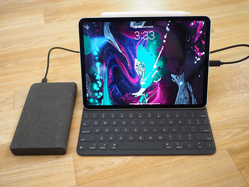

Though designed for the MacBook and MacBook Air, you can use the Powerstation 3XL to provide a bit of extra juice for a 13 or 15-inch MacBook Pro, but as these are higher-capacity devices that use 61 and 85W power sources, respectively, the 26,000 capacity won't go as far nor will charging be as fast.
mophiechargeripadpro
With the MacBook the Powerstation 3XL offers more than double the battery life, and while I don't have a MacBook Air to test, it too should be able to charge to full via the Powerstation. You can charge an iPhone or an iPad a few times over as well, so this is a great device to have on hand for travel and other situations where you need a lot of battery life.

I have nothing negative to say about the Powerstation 3XL itself. It's heavy and a bit bulky, but that's to be expected from a charger with such a high capacity. It's well made, I love the grippy fabric covering, and it charged up all of my devices flawlessly.
