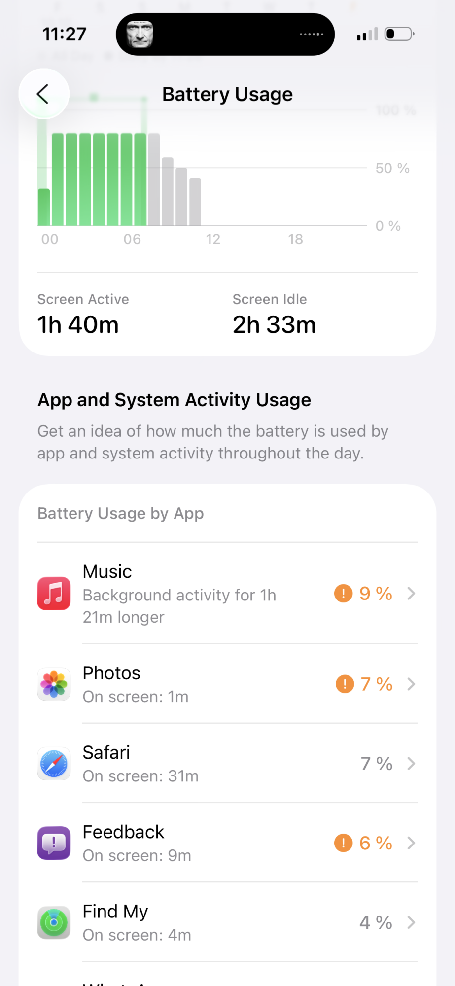

If only it had decent battery life to begin with.
I can easily go from 80 to 20% in 2.5 hours using Safari and Apple Music. It’s rough on my 93% 15 Pro, 18 was already bad but now I miss 4 hours of usage for the same amount of drain.
Edit: the battery page is outrageously useless too, compared to iOS 18.
Attachment Image
Score: 17 Votes (Like | Disagree)
