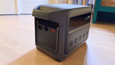

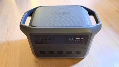

The C1000 has your standard power station aesthetic, made from durable black and gray plastic. It has two handles at the sides, which makes it simple to distribute the weight across two hands, along with fan grilles and an LED display that shows the current power level and the power draw of anything that's plugged in. Rubber feet at all four corners ensure that it remains stable.
There's no revolutionary design here, but the Solix C1000 looks and feels rugged. Curves at the corners make it feel a little more modern than some other power stations, and while it's not waterproof, you can get a protective carrying case that keeps it safe from moisture. It's 25 pounds, so it's probably not a battery that you're going to want to be lugging to the beach or the park, but it is good for all-day power if you're in a location where dragging around 25 pounds isn't a hassle. It isn't overly large, measuring in at 15 inches by 8.2 inches by 9.6 inches.

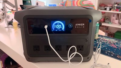

At the front, there are five AC outlets, two 140W USB-C ports, one 15W USB-C port, and a 12W USB-A port. I appreciate that Anker is phasing out USB-A and only included a single USB-A port, because USB-A connectors are growing more uncommon. In the future, you may have no USB-A devices at all, so you won't have several wasted ports. 140W USB-C should also be good for years to come. There's a charging port at the side, a solar input port, and a 12V car port.
I like the port arrangement, and was fine with all of the AC ports on the front, but spacing could be an issue if you want to plug in multiple devices with large plugs. For the AC outlet, you need to turn on AC power manually, a feature that exists to prevent battery drain when idle.

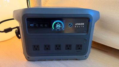

What's great about the C1000 is that it tells you exactly how long it will last based on the power draw of what's plugged in. On the LED, you'll see an estimated readout. It predicted around 14 hours of usage for my 67W ‌MacBook Air‌, which was accurate.

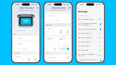

Anker has an app that connects to the C1000 over Wi-Fi or Bluetooth. You can use the app to check power level, power draw, and time remaining when a device is plugged in. You can also turn on the AC output or car charger output from the app, and fine tune controls like charging power, device timeout, charging and discharging limits, and more. It delivers new firmware too, which I struggled with. For several days, the firmware update kept failing, but it worked flawlessly later on, so I'm not sure what the issue was.
